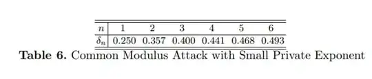

On the other hand, there are some works that improve the other attacks in the literature by using Common Modulus Attack as mentioned here. Originally, Wiener's Attack requires $d<$$(1/3)$ $n^{0.25}$ for the recovery of the private exponent $d$. In this work, it is relaxed to $n^{0.357}$ by using another instance. Additional results for different number of instances can be found in this paper as:
So for the situation of $gcd(e_1,e_2)≠1$, Common Modulus Attack can be more effective for the small private exponent case which is not suitable your request. - since you are interested in small public exponents which guarantee private exponent to be large-
