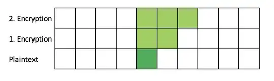

Now, assume that we lost any of $D_1, \dots D_{nb}$. This mean that we cannot decrypt two $C_i$'s per loss.
What if we got only 3 consecutive $D_i$'s? Say; 4, 5, and 6
\begin{align} C_4 =& D_k(\color{red}{D_4}) \oplus D_{3}\\ \color{green}{C_5} =& D_k(\color{red}{D_5}) \oplus \color{red}{D_{4}}\\ \color{green}{C_6} =& D_k(\color{red}{D_6}) \oplus \color{red}{D_5}\\ \end{align}
This mean, if we get only consecutive 3 ciphertext blocks of the second decryption, namely from $D_i$s, we can decrypt 1 ciphertext block as;
\begin{align} P_6 =& D_k(\color{green}{C_6}) \oplus {\color{green}{C_5}}, \end{align}
So, the proposed method, twice encryption, is not an All-Or-Nothing Transform (AONT).
In CBC mode, two consecutive blocks can decrypt one, 3 consecutive can decrypt 2. This was the core.

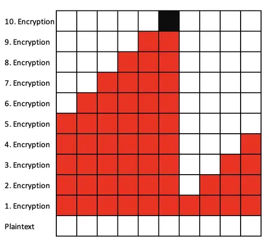

If we consider deeper with this; we can see that we need $nb$ pass for CBC mode so that the loss of one ciphertext from the final layer will prevent all layers from decryption. In this way we can achieve AONT.
Consider the 10 layer encryption and see how the loss of one block spreads.
