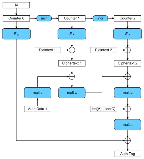

No, because it's not simple (primitive).
The following is a cryptographic construct that facilitates encryption and authentication:-
aes-gcm
And it has a lot of bits to it (not a pun). Building blocks if you will. As does a block chain. And it's complex, as is a distributed block chain. The encryption $E_K$ is a component, like the XOR mathematical function (not cryptographic). Lego bricks (UK nomenclature).
You could make the argument that block chains are cryptographic in the same sense of game theory, key exchange and secure multi party random number generation all falling within the cryptographic realm. But all of those are built atop simple (primitive) operators like block ciphers, hash functions and ridiculously sized prime number functions. They're applications. So they're not building blocks. They're houses made of bricks. They're not simple and can be sub divided into smaller cryptographic operations.
