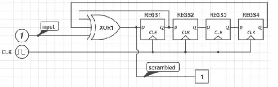

The simplest towards THAT goal (NOT towards the more righteous goal of improving the generator) is to add post-conditioning with an LFSR-based scrambler. Below is an example with polynomial $x^4+x+1$ (or $x^4+x^3+1$ depending on convention).
LFSR conditionning
Such scrambler improves the results of most predefined statistical tests (and demonstrably can't weaken an already good TRNG). I think that for an otherwise passable generator, the excess probability of failure of the Non-Overlapping Template Matching Test (and many other tests, with Linear Complexity Test a likely outlier) decreases exponentially with the degree of the polynomial used (it must have a constant term, and it's better if it has some other coefficients). But that does not necessarily make the TRNG more suitable for cryptographic use; see why here.
