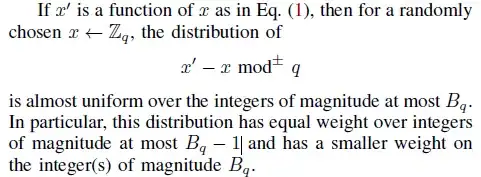

  1. In the paper on page 4 it says:
  • Unfortunately, there is no explanation why this is the case. I have had the distribution plotted once for selected parameters and would agree with this, but that's more of an argument based on experience. But can this also be formally justified e.g. by a calculation?

I like to think of the the compression and decompression function operating on the numerators of fractions in the range $[0,1)$ (wrapped around) whose denominators are either $2^d$ or $q$. The compress function maps a numerator whose denominator is $q$ to the numerator of the nearest fraction whose denominator is $2^d$ and the decompress functions maps a numerator whose denominator is $2^d$ to the numerator of the nearest fraction whose denominator is $q$. Note that because $2^d<q$ compress is surjective and decompress is injective.
Between each pair of fractions with denominator $2^d$ there are either $[q/2^d]$ or $[q/2^d]+1$ fractions with denominator $q$ (more precisely, there will be $q\mod{2^d}$ pairs of the first kind and $2^d-q\mod{2^d}$ of the second kind. Similarly, by taking the halfway point between each pair of fractions with denominator $2^d$ we divide the wrapped interval $[0,1)$ into $2^d$ subintervals where the compress function is constant on the subinterval. Again, the number of fractions with denominator $q$ in each subinterval is either $[q/2^d]$ or $[q/2^d]+1$. Now note that the pair of integers $[q/2^d]$ and $[q/2^d]+1$ are either $2B_q$ and $2B_q+1$ or $2B_q-1$ and $2B_q$.
In the case with $2B_q+1$ fractions with denominator $q$, we have a central fraction that is closest to the fraction with denominator $2^d$ in the middle of the subinterval. The numerator of this central fraction is fixed under $\mathrm{decompress}(\mathrm{compress}(x))$ and corresponds to $x'-x=0$. Each of the $B_q$ fractions with denominator $q$ to the left of the central fraction in the subinterval has corresponds to a $x'-x$ value $-B_q,-B_q+1,\ldots -1$ and similarly the $B_q$ fractions with denominator $q$ correspond to $x'-x$ values $1,2,\ldots, B_q$. Note that this case corresponds to complete uniformity of all $x'-x$ values.
In the case with $2B_q-1$ fractions with denominator $q$, we again have a central fraction that is closest to the fraction with denominator $2^d$ in the middle of the subinterval. The numerator of this central fraction is fixed under $\mathrm{decompress}(\mathrm{compress}(x))$ and corresponds to $x'-x=0$. Each of the $B_q-1$ fractions with denominator $q$ to the left of the central fraction in the subinterval has corresponds to a $x'-x$ value $-B_q+1,-B_q+2,\ldots -1$ and similarly the $B_q$ fractions with denominator $q$ correspond to $x'-x$ values $1,2,\ldots, B_q-1$. Note that this case corresponds to uniformity of $x'-x$ values not including $\pm B_q$.
In the case where there are $2B_q$ fractions with denominator $q$, there is a ``central'' fraction that is nearest to the fraction with denominator $2^d$ in the subinterval, but an imbalance that means either there are $B_q-1$ fractions to the left and $B_q$ fractions to the right or vice-versa. The former corresponds to uniformity of $x'-x$ values not including $-B_q$ and the latter to uniformity of $x'-x$ values not including $B_q$.
In all cases we have uniformity for $x'-x$ values not including $x'-x$; in the case $2B_q-1$ and $2B_q$ we have a smaller weight for some integers of magnitude $B_q$. Not all cases can fall into the $2B_q+1$ because $q\mod 2^d\neq 0$. This explains the remark in question 1.
