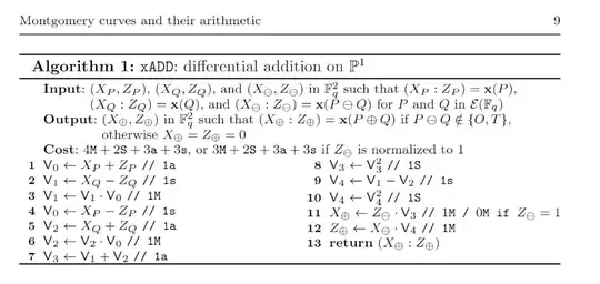

Based on Differentia-addition on P I can understand (Xp,Zp) which is the base point, (Xq,Zq) which comes from Doubling, but I don't know what is the equation used to get P-Q to get X-,Z-.
So for example if I have P1(8,3,1) so it means (X⊖,Z⊖) = (8,1) and the value of (Xq,Zq) is from doubling? what about (Xp,Zp)?
Actually, if you're using the Montgomery Ladder algorithm, it's the base point we're multiplying.
At each step of the iteration, we have the points $P, P+G, G$ (where $P = zG$, where $z$ is the part of the multiplier we've already entered), and depending on whether the next bit in the multiplier is a 1, we want (if it is a 0) $2P, 2P+G, G$ or (if it is a 1) $2P+G, 2P+2G, G$.
So, the first step is to take $(X_P, Z_P) = P+G$, and $(X_Q, Z_Q) = P$, and $(X_\ominus, Z_\ominus ) = G$; it is easy to see that the precondition $(X_P, Z_P) - (X_Q, Z_Q) = (X_\ominus, Z_\ominus )$ holds; the addition algorithm then gives us $(X_\oplus, Z_\oplus ) = (X_P, Z_P) + (X_Q, Z_Q) = 2P+G$. And, all we need to do is compute either $2P$ or $2P+2G$ - either case is just a doubling of a value we already have.
And, to start the process, we start with $P=0$ (hence our triple is $(0, G, G)$, which fulfills the precondition, and then we can start by shifting the multiplier bits in, in msb to lsb order...
Hence, in this application, $X_\ominus, Z_\ominus )$ is always $G$ (the base point we are multiplying by).
