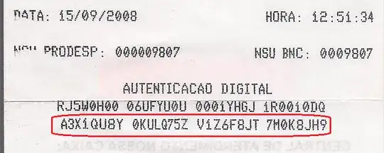

Assuming that's no longer in use: any info about what Paulo S. L. M. Barreto reported has been successfully used for VAT receipt purposes in the province of São Paulo (Brazil) 2008-2013, with 160-bit signatures of security then conjectured roughly equivalent to RSA-1024?
Brazil 2008 VAT receipt
