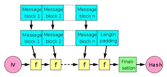

Example: the Davies-Meyer Compression function. Some hash functions, such as MD5, SHA-1, and SHA-2, are examples of Merkle-Damgard constructions. Let's say we'd like to find an argument that Merkle-Damgard constructions are collision-resistant. They look like this (IV is a constant, and Hash is the output):
A Merkle-Damgard hash function
The function $f$ above is a compression function. Now, it's possible to show that if $f$ is secure, then so is the hash function. But we can go a bit deeper using the ideal cipher model. For MD5, SHA-1, and SHA-2, $f$ is built out of a block cipher $E$ using a so-called Davies-Meyer construction (each of these three hash functions uses a different block cipher):
$f(\mathrm{M}, H) = E_{M}(H) \oplus H,$
where $M$ is the message block and $H$ is other input (the chaining value). So $M$ is being used as the key, but if someone is trying to find a collision for MD5, then each message block $M$ is under his control. It is neither random nor secret. So we can't use the PRP assumption.
But we can model $E$ as an ideal cipher. Using this assumption, we can show, for example, that no one could find a collision for MD5 or SHA2 without doing an insane amount of work (or getting really, really, lucky).
