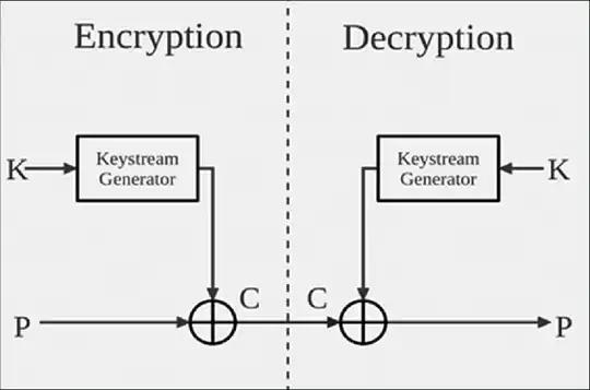

As the other answers say, the reason is that XOR is invertible. Your diagram shows exactly that: $$f(P, K) = C$$ $$f(C, K) = P$$
Actually, there are many functions that are invertible.
If we operate on separate bits (argument length is 1 bit, or arity = 1), then besides XOR we can construct other invertible functions, for instance: $$f(P, K) = \lnot (P \oplus K)$$ Its inversion function is: $$f^{-1}(C, K) = (\lnot C) \oplus K$$

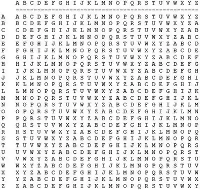

pad
