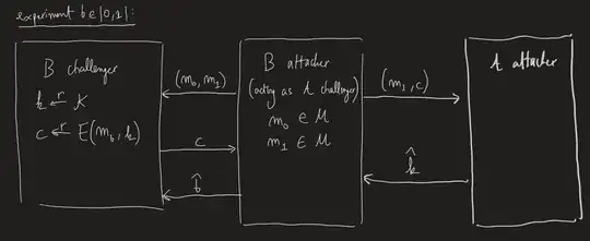

I use the following construction of $\mathcal{B}$:
Here we set $\hat{b}=1$ if and only if $D(\hat{k}, c)=m_1$.
Experiment $b=1$: the ciphertext $c=E(k,m_1)$, and so $(m_1, c)$ is a valid pair in the key recovery game described above. Therefore $Pr[\hat{b}=1\ |\ b=1]=\text{KRadv}[\mathcal{A}, \mathcal{E}]$.
Experiment $b=0$: the pair $(m_1, c)$ is no longer a valid pair according to the key recovery game since $c=E(k, m_0)$. For $\hat{b}=1$, we would need attacker $\mathcal{A}$ to output $\hat{k}$ such that $D(\hat{k},c)=D(\hat{k}, E(k, m_0))=m_1$.

Let $m_1$ be sampled uniformly at random from $\mathcal{M}$. In this case $c=E(k,m_0)$. From any ciphertext, we have at most $|\mathcal{K}|$ possible messages that we can decrypt to. Let $$S=\{D(k', c)\ |\ k'\in \mathcal{K}\}$$ then $$Pr[m_1\in S]\leq\frac{|\mathcal{K}|}{|\mathcal{M}|}$$
If the event $m_1\in S$ occurs, then attacker $\mathcal{A}$ has probability $\text{KRadv}[\mathcal{A}, \mathcal{E}]$ of finding a key $\hat{k}$ such that $D(\hat{k}, c)=m_1$. Otherwise, when $m_1\not \in S$, we have probability $0$ of finding such a key because none exists. Hence
$$\text{SSadv}[\mathcal{B}, \mathcal{E}]=|\text{KRadv}[\mathcal{A}, \mathcal{E}]-Pr[m_1\in S]\cdot\text{KRadv}[\mathcal{A}, \mathcal{E}] |\geq\text{KRadv}[\mathcal{A}, \mathcal{E}](1-\frac{|\mathcal{K}|}{|\mathcal{M}|})$$
And so we are done.

I belive that there isn't a way to know how much $\hat{k}$. And even if we did it isn't correct to assume that $Pr[\hat{b}=1|b=0]=\frac{x}{|K|}$.
To handle the analysis when $b=0$ try fixing $c$ and looking at what is the maximum number of messages such that there exits a key $k$ such that $E(k,m) = c$. Also look at the probability of a message being in this specific set.
