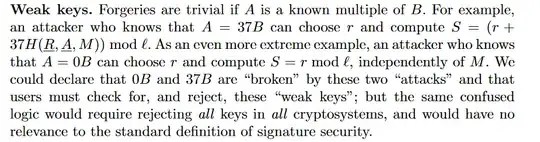

  • Bernstein et.al. argue that excluding weak keys (including zero) is not a way to go: enter image description here

  • Bernstein's ECC does prevent the public key to be the point at infinity, by the very mapping of bitstrings to private key in key generation (specifically "the second highest bit of the last octet is set").
  • Bernstein's argument that we need not care for the point at infinity to be reached is made for intermediary results other than the public key, e.g. in EdDSA. It makes perfect sense when there is no special case needed for the point at infinity, as in the coordinate system/kind of curve that Bernstein advocates.
