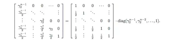

I finally found an answer! It is explained in the thesis of N. Gama (page 36), available here. I copy the matrix whose rows form a basis $B$ of a lattice for which the upper bound $$\| LLL(B)_1 \| \leq (4/3)^{(n-2)/2} \lambda_1(L)$$ is actually tight (sharp) for all $n$. (Note the exponent $n-2$ and not $n-1$).
basis
where $\gamma_2 = \sqrt{ 4/3 }$ is Hermite's constant in dimension 2. Note that the triangular matrix on the right is the matrix of Gram-Schmidt coefficients, the off-diagonal entries are all $1/2$ which is the maximum allowed in the definition of LLL-reduced basis.
