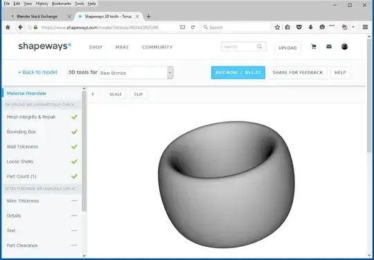

We print a lot of stuff in a variety of materials, and I think it is likely what you are experiencing is a problem caused by some combination of the following: Object size overall, object detail size, wall thickness, or span width/thickness.
Blender gives pretty clean stls, but the last-mile needed to get output is primarily a materials engineering problem.... (and saying thias, I am assuming you got a valid stl that the printer was able to read and rip...)
A first thought: Try loading your stl into one of the services that price online. Shapeways does, and Cubify does or did... and you can download the driver software for the Form2 even if you don't own the printer.
Bring your stl into these apps and look for error messages. The Shapeways ordering app does a nice job of showing issues, particularly ones like wall thickness and manifold faces/vertices (another possibility I did not mention above) very quickly.
I'd offer to look at your stl if it is something you can share... and/or you can ask your output guy for a sample stl he has printed with some success before. Bring that stl file into Blender beside your model and compare.

Here's a torus at Shapeways I uploaded....
