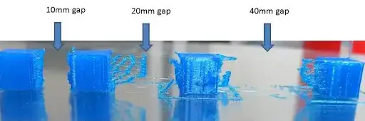

3. Distance between objects
From the article linked at the top:
The faster you’re able to move to the next print position, the less time there is for filament to ooze from the hot end
As such, the distance between the printed objects will change the characteristics of the stringing:
Effect of object distance
