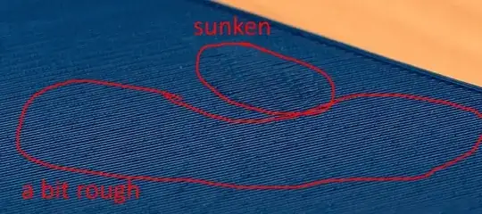

Photo from part A (RPi case top piece):
rough and sunken

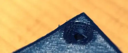

Photos from part B (RPi case bottom):
There is a really ugly screwhole (sorry for the blurry picture):
Ugly screwhole

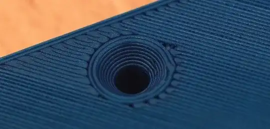

But in the same part, there's an almost perfect much better screwhole:

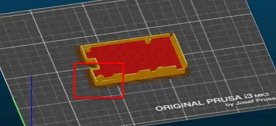

For the location on the print bed, it's here (both parts):
Problematic region

I know you said you don't want to change the Z height, but it does look like you're printing a bit too far from the plate. I would recommend adjusting your Z-offset if you can, or adjusting the limit switch (or whatever your Z-homing mechanism is)
kolosy
  • 591
  • 13
Definitely the corner of your bed where print was worse is slightly unleveled (a little too low), because if you look the hole, it has artifacts too, probably because the nozzle was depositing the melted filament from a higher distance than on the "good" part.
You can see later in that hole, that the layers finally catch up with the rest, so:
  • You need to correct the bed leveling on that corner (too low)
Also, the better part doesn't look right either. You can see the ring around the good hole doesn't close because the filament din't stick at the beginning of the circular movement. Plus, your first layer should be smoother than that, not wormy-like.
To experiment how to get a better first layer you need to tweak in very small amounts:
  • The first layer height (I may need to be lower for you)
  • The temperature (I don't think you need more temp for your first layer, probably the fans start blowing after the second layer anyways)
  • The % of extruded material (you may increase it in very small amounts only for the first layer [and only after a lower layer height didn't worked])
  • The speed of the first layer (it may need to be lower. imagine your nozzle is trying to print with chewing gum and what would happen if speeds are too high, PLA has a rubbery consistency when melted)
Also:
  • Be sure the surface is clean
Dust and oils from manipulation on certain spots can cause the filament not to stick, even when you think is clean. I use alcohol when printing on a bare surface, change the masking tape, or use just a paper towel (when I'm using PEI sheet)
If that doesn't give you a a better first layer, but it is at least even, you will need to adjust your z-axis offset or level the entire bed up a little.
