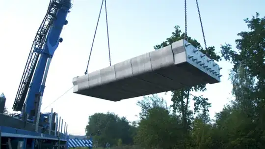

According to BAM Infra:
“They have succeeded in developing a process to also print the steel reinforcement at the same time. When laying a strip of concrete the concrete printer adds a steel cable so that the slab is ‘prestressed’ so that no tensile stress can occur in the concrete.”
Concrete bridge element with rebar for pretension
But this means that the print is a part printed at another location, not on location.
