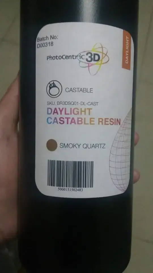

I have a 3D printer and I have printed some models with castable resin. When I burn one of these models in the oven and then do the metal casting, the surface of the metal piece is not smooth.
I did a test with a pan. I put a model of wax and a model of castable resin to heat in a pan, and the wax model melts, but the resin model don't.
The resin I have is the following:
What is the correct process to make a correct resin casting?

Resin is not soft wax or a thermoplastic.
No, in fact, most resins are a duroplastic, meaning that they don't melt.
If you print a positive from resin and then make a mold from that for lost mold casting, you go the traditional way. But most resins don't melt out the way wax does, and on contact with molten metal don'T evaporate the way wax residue does. You got to properly burn out the remains of the cured resin at a higher temperature and for a longer time than the wax as the melting point is much higher - use a proper burning oven. A proper burning oven in this relation reaches something like an email oven (1100 °C) or a clay burning oven (up to 1800 °C)
Putting the molds with the opening down into one of these ovens at high temperature should help a lot. Make sure to put a spacer and a tray below to allow better airflow and get the resin out.
