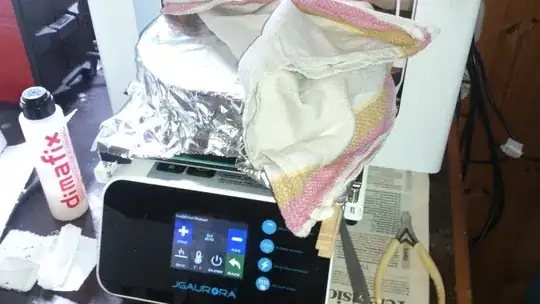

Here is my suggestion for a cheap, well and temperature accurate drying manner of a filament. I've done it several times for PETG that is actually a very moisture absorbing filament and pops it up when using by ruining the job. Why not using your own printer's heat bed to dry the filament (PETG about 6 hours in 65 degrees of Celsius)? I can guarantee that it works: PETGs Drying On a Heatbed
