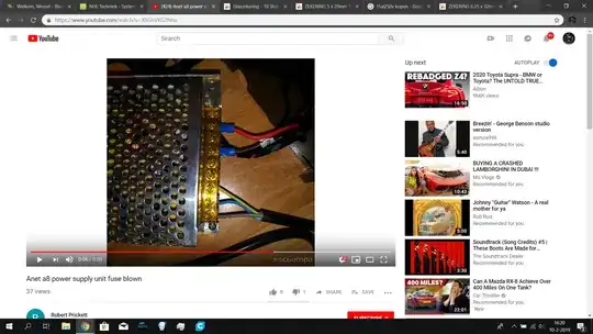

I put all the wires in correctly (as shown in this YouTube video, Anet A8 power supply unit fuse blown, I just searched really quickly, this person has the same problem as me) and "BANG", it blew.
Image from YouTube video

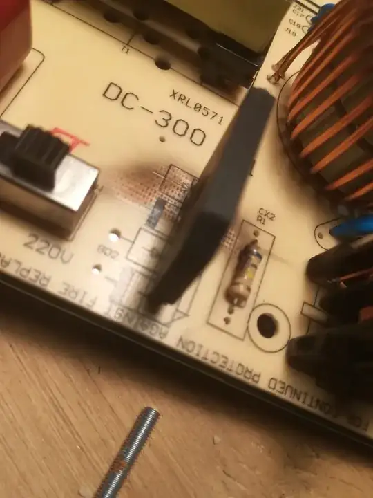

Upon closer inspection I found a burned out resistor in the circuit of the power supply, maybe this caused the bang?

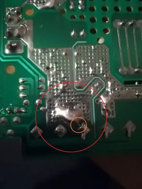

I opened it up and flipped the board, and noticed that there was a big ol' blob of tin connected to one of the pins I connected my wires to. I am very sure that this blob shouldn't connect to that pin at all, hence shorting my board.
Is this the cause?
Close up of PCB
Close up of PCB - Highlighted potential short circuit

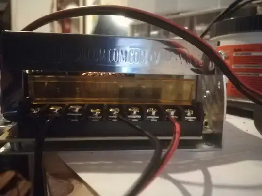

Here is how I wired it up at the PSU side:
Power supply connections

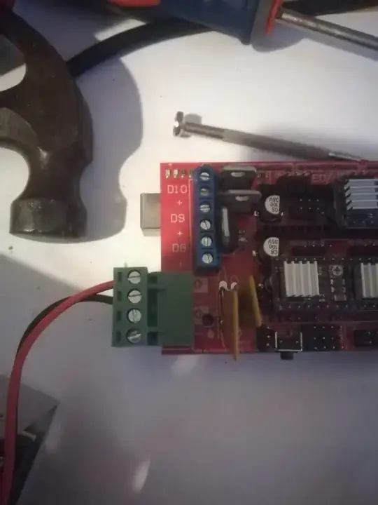

At the RAMPS side:
RAMPS board connections
This shows the internals of the PSU, it clearly shows burn marks:
Overview of the failed electronic component in the PSU
You need to closely look at how to connect to the output connectors. In this case it appears that you have wired it correctly according to the stamped in markings above the connectors. You have chosen not to connect the earth, this is strongly advised.

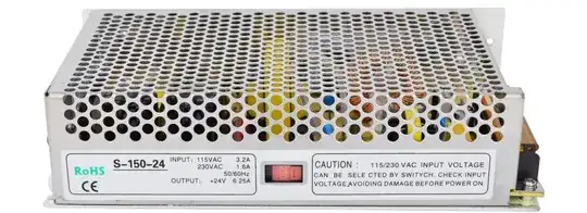

Did you check if the power switch matches the voltage of your country? If you are in Europe the switch should be set to 230 V, not 115 V (which is used in America).
E.g. for the following power supply you see such a switch on the side: PSU voltage setting
