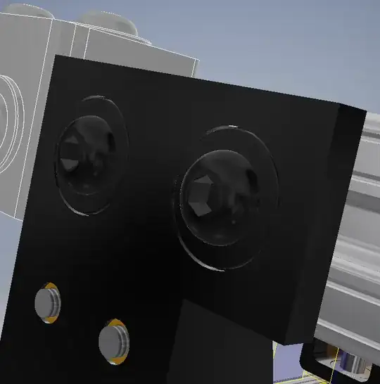

In my designs I also put in a depression to fit the washer so that it sits flush with the resultant surface.
Cad design with recessed washer holes
