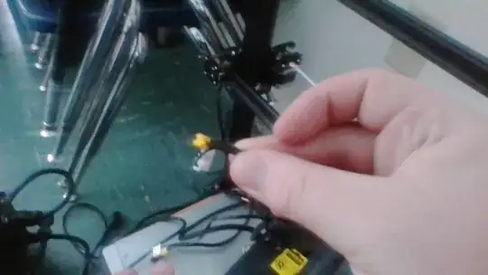

Did you make sure that the x,y,z and other cords / connectors, were connected to the right areas? TO clarify, the things that connect into the motors.What I was trying to explain. Apologies for the low quality.
