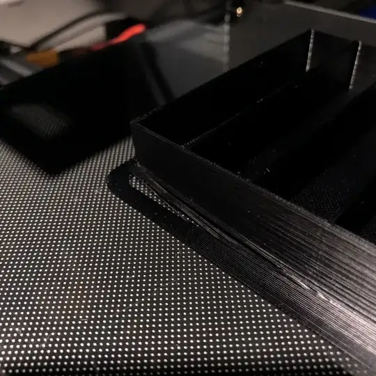

I am using an Ender 3, on which I have modified the heatbed to carry a glass sheet, otherwise factory standard. The prints are done on the bare glass. When I printed a window some 14 feet (~4.5 meters) away was open to the cold New York winter. The cooling fan on the Ender 3 is mounted on the right side of the hotend and uses a simple declector, it can be seen in picture 2.

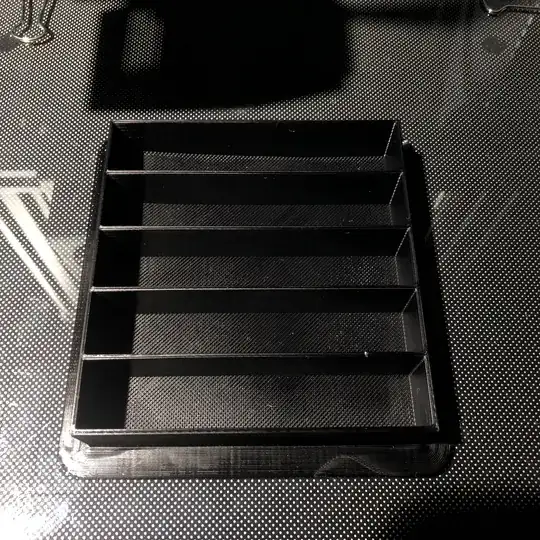

One failing corner of the print
Good sides and hotend on the gantry above

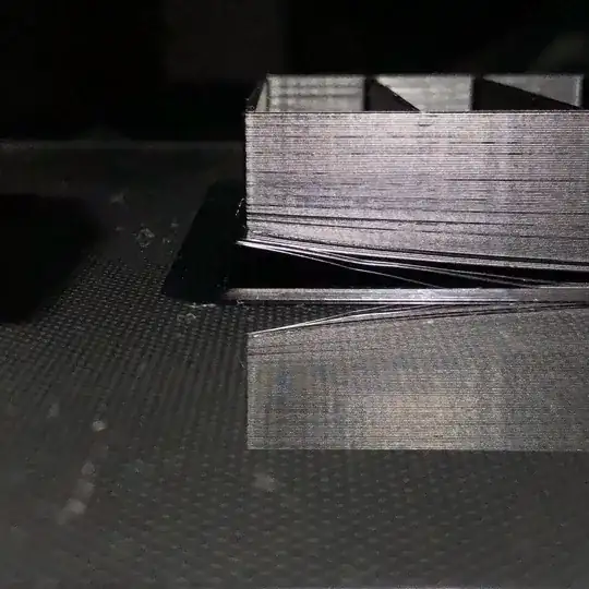

Another angle of bad side

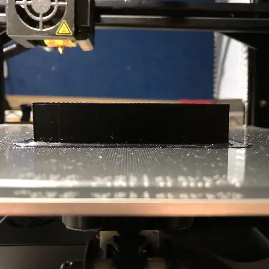

top down

Based on the pictures, this looks like the bed wasn't clean enough, thus why it didn't adhere correctly in some spots. The lifted corner is the worst, but I can see a couple more spots where the PLA didn't stick well enough, though the brim prevented it to completely lift off the bed.
