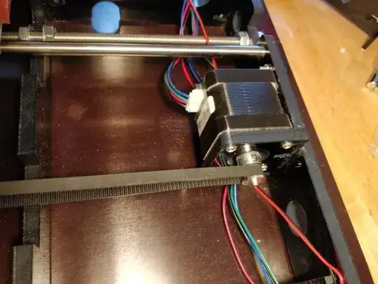

This is the motor mount: enter image description here

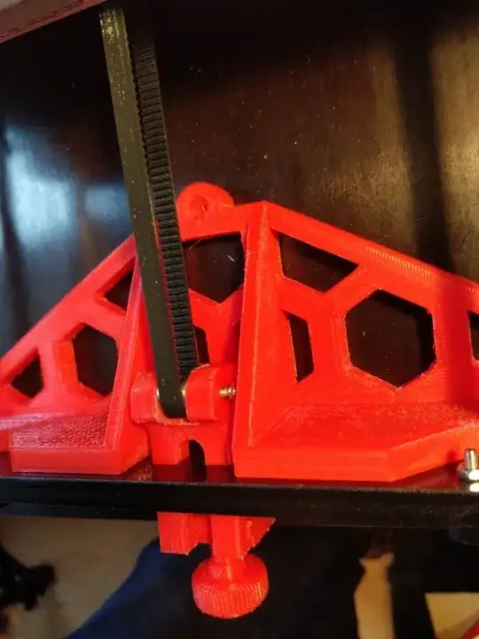

And this is the tensioner with the support frame: enter image description here

With the second video and the photos I could identify, that the sound in part stems from the belt:
  • It is too loose and swing sideways as it pulls.
Tighten the belt till it sounds at least like a C3 or D3 (130/146 Hz) and possibly higher. My Ender3 is tuned to something like A3 (220 Hz). It should be tight and show no sideways swinging on using the motor.
It seems also, that the belt is not running parallel but skewed - that would induce sideways swing too. Make sure the axis of the motor and the pully are parallel and the mounting point of the carriage is not sideways of the belt path, as this will rub the belt against the gear.
