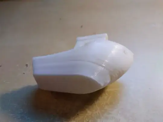

The most annoying point, on the following image, is the dent that I have in the hull, on the front of the boat. And one layer appears to be missing or close. And I have another one just like it in the top cabin. I also think that my specific settings on the first layers shouldn't be there, because they don't improve anything, but that is another topic.
3DBenchy boat with dents

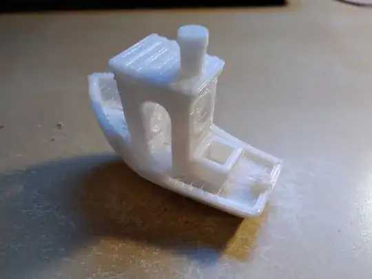

Also, when I look on the top, I have a lot of filament strings getting here and there, the path of the tip of the printer is quite visible on the roof and floor, the steering wheel is not to clear, etc. enter image description here
Also, at the end of the boat, I am supposed to have some letters, but I cannot read them because of the poor definition of the print...

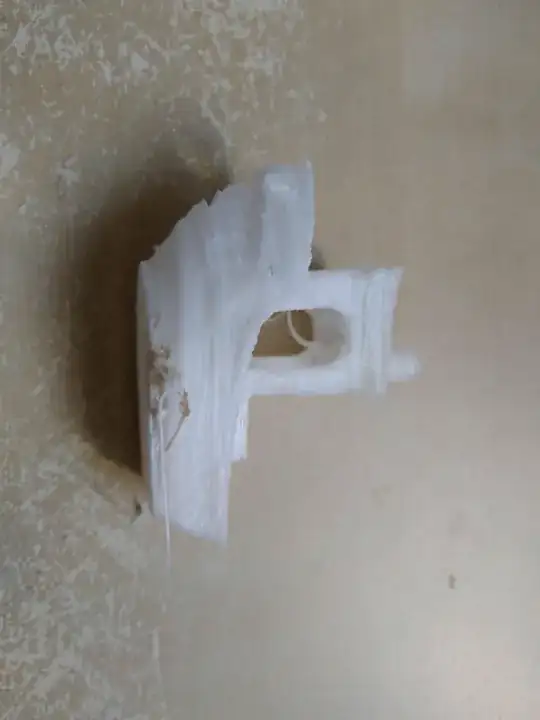

After modifications of temperature and cooling, following the answers, I got the following print: (Nozzle 200 °C, fan at 50 %) New boat with burn dent. Burned plastic
Weirdly, it was like the PLA got burned here and there, which was not the case at hotter temperature... But at least, the edges are sharper, and the writings are easier to read! I will try to lower a bit more the temperature, but I would need to fight a bit with my extruder motor, which seems to have hard time pushing the PLA when the temperature is too low.

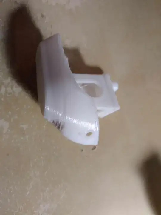

I tested at an even lower temperature: 190 °C. The result is not pretty, the layer were not sticking to each other. And even at 195 °C, some layer don't attach. Low temperature print.

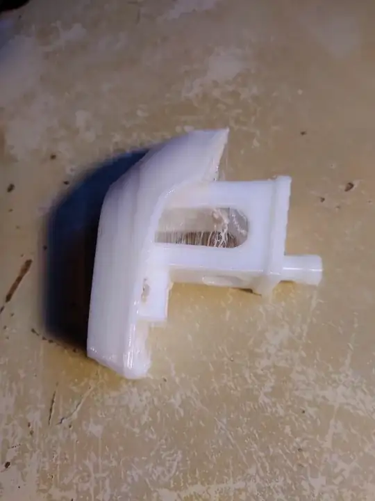

I tried again at 200 °C, but with lower peripheral printing speed. It did help! I can feel the progress. enter image description here

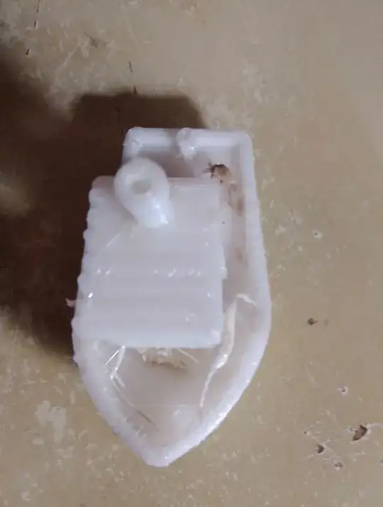

However, I still have a small dent. And on the following picture, we can clearly see that there are sometimes molten half-burned PLA dripping. And there are still strings remaining between the places. Molten PLA
The nozzle was cleaned just before this print.

Your hotend temperature is too high and/or too less part cooling. The part cooling is very important to solidify the hot fluid filament in time to have a solid fundament for the next layer. PLA has a reasonably low glass temperature (at this point the filament is weak and mealable/flexible, at about 60 °C), if the part is not cooled properly, the part temperature can be over the glass temperature when printing the next layer and will distort the previous and current layer.
I print PLA at a maximum temperature of 200 °C (for my thermistor reading).
A combination or a single of these parameters not being the correct value will cause the dent at the front and the stringing and letters to be faded as the filament is not cooled properly and deforms the previous and current layer, this easily shows up in overhangs like at the bow of your print.
Try to lower the hotend temperature by 5 °C per next calibration print (or start at 200 °C and work down from there) and increase the part cooling a little if possible (35 % to 50 %). The build plate generally does not need to be 5 °C higher for the first layer nor do you need an extra 5 °C for the hotend, PLA is not that difficult to print.
