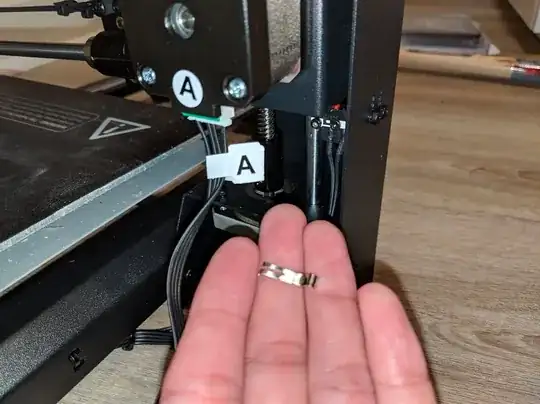

I recently bought my first 3d printer, a monoprice maker select v2.
After a couple of print jobs, this piece fell out.
Printer part
I have no idea where it came from.
But afterwards, I notice that my Z-positioning is all screwed up.
When I select "Home All" to reset all positions to do bed leveling, the extruder tries to push down pass the build-platform, puncturing a hole into the plastic bed cover. There was a lot of clicking from the motor so I immediately turned it off.
I turned it back on and then tried to move the z-position back up. But it moves only about an inch up before the motor starts clicking again.
I was reading some other posts about a "Z-axis limiter switch". Could that be what the little metal fork-like piece is? Where does it go and how do I put it back? And how do I reset my z-position?
Any help appreciated.

Limiter Switch/Endstop

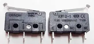

That is the lever that is meant to trigger your Z-Endstop. The variant used in your case is on the cheaper end and is meant to look similar to this QIAOH KN12-1 limit switch:
a KN12-1 Qiaoh micro limit switch
You will either exchange the endstop as a whole, somehow reattach the/a lever or change the physical position of the endstop so that the moving X-axis is triggering it (again).
