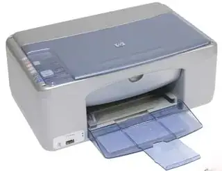

I thought as a fun project to make my own 3D printer out of a normal printer parts + some parts out of old CD-ROM drives that are lying around. The printer of my choice is an HP PSC 1315 one. HP PSC 1315 All-in-One Inkjet Printer

No, Printers are not good sources
Common printers contain at best one stepper motor in the scanner, and it is usually too weak for use as an X or Y stepper, but for a very slow printer they might be useable, especially if you could source 2 or 4 of the same type.
The main motors in the printer are almost universally DC motors that get their turning signal as a voltage from the main board, which again uses positional information from an encoder strip/disk. Using both of these to make a 3D printer is usually not feasible.
However, they usually have good rails (sadly often of non-standard diameter) and might be salvaged for a decent optical sensor. See also Thomas Sanladerer's video about this.

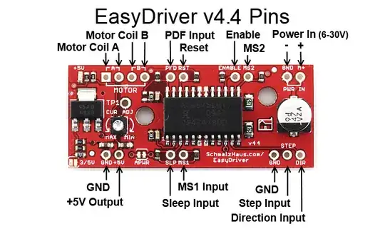

Here is the A3967 stepper driver
