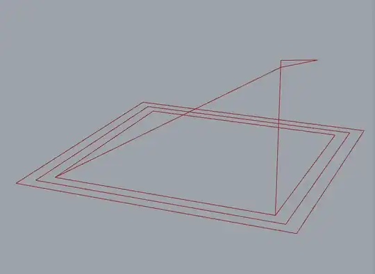

Here is the sequence of my Gcode, printed in mid-air:
Print (E20)
Retract (E-20)
Dwell (G4 10,000)
Move away (E0)
Print (E20)
See the path on the printscreen below: enter image description here
When the printer dwells it oozes. How can i stop that?
