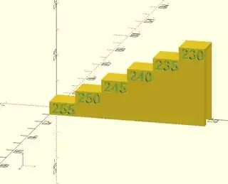

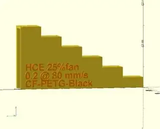

Sidemark, I prefer the use of parametric models (e.g. in OpenSCAD) over the STL models found on the internet, this way I can embed the exact printer setting in the tower for reference. See e.g. this answer.
Heat tower front viewHeat tower backside view
