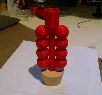

I'm trying to print the following model in my Prusa printer using its Slic3r PE software.
Ferment Air Lock
Ferment Air Lock
In the comments of the model it says that the way to print is the with the filler opener downside to the printing board.

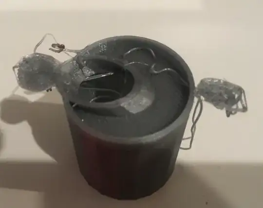

When I print it I get this horrible form and I have to stop in order to avoid waste of material.
Bad print

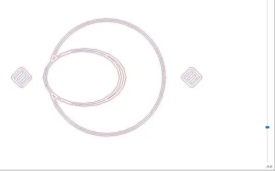

When I look in the layers tab and then scroll up to see layer workflow I can see this:
Layer workflow
So that means is trying to print like in the "air" something without any support.

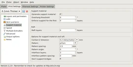

You need to put a check mark to enable supports in Slic3r as you cannot print in mid-air.
This option is found under "Print settings" with header name "Support settings". Please look at the Slic3r manual for more options.
Slic3r print settings
