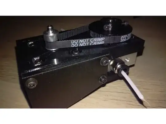

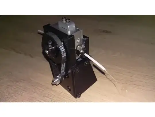

A similar calculation shows that for a 0.2 mm nozzle on a 2.85 mm filament extruder a gearing ratio of $ 1:5.3$ is required. This "extra room" for extra torque to fit smaller nozzles also explain the larger gear reductions. What is optimal is not only defined by the nozzle size and filament diameter but very dependent on the stepper motor and the torque it can produce. Gear reductions should be limited so that they do not minimize overall print speed or cause problems with retraction (this latter I experienced myself, a too high retraction speed caused the stepper to miss steps on my custom designed 1.75 mm to 2.85 mm bulldog extruder conversion. I'm using a $1:4$ speed reduction to produce enough torque with a stepper that is normally used for direct drive (of 1.75 mm filament). Note that within the aluminium bulldog housing, a different sized extruder gear is used to accommodate the larger diameter filament: Bulldog 1.75 to 2.85 mm conversation extruder Bulldog 1.75 to 2.85 mm conversation extruder
