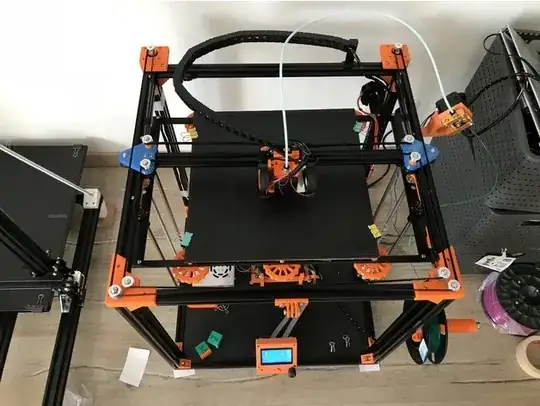

I have added this upgrade to my printer for the idlers and motor mounts:

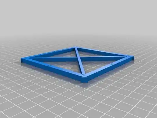

Its seems Oscar was correct in his assessment that my printer is not printing square. I printed this calibration square to measure the diagonals and I got: $ \overline{AC} = 141.82 $, $ \overline{BD} = 141.35 $. I believe the correct value for these diagonals should be $ \sqrt{2} \times 100 \approx 141.42 $.
calibration square

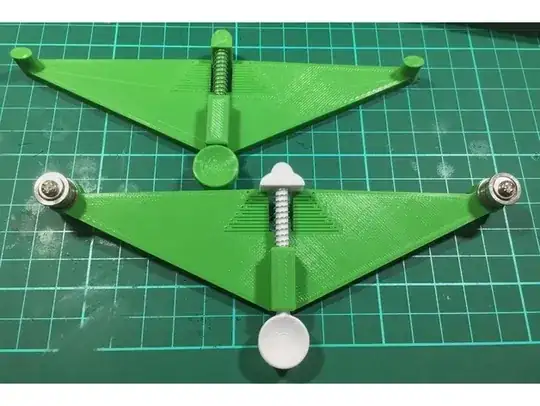

Indeed, even belt tension is important, what helped me enormously to set the same tension in the belts on my self build CoreXY is a tool like this:
Belt tension measurement tool

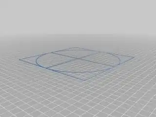

Also make sure that the print is not skew, i.e. are you sure that the printer prints squares? This can be easily checked by printing a large square and measure the diagonals; I used this as it will also help you find the center of the bed and the level of the bed all at once:
Calibration square

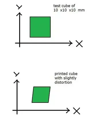

but many calibration prints can be found on the internet, e.g. this one but this requires way more filament to print). Schematically this results in something like depicted below:
Schematic overview of a skew print
If it is not square, you can adjust this by using a different firmware like e.g. Marlin Firmware which has options for skewness compensation that can be addressed in the Marlin Configuration.h file. A "cube" that is printed by stacking parallelograms also shows different dimensions is X and Y (one being smaller, the other being larger).
