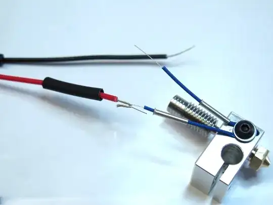

Additional info: Can't you clamp the thermistor the way it is done in the E3D V6 hotend, see this image?
Thermistor in E3D V6 hotend
Thermal contact should be quite good and you don't have any problems which could lead to damage of the thermistor.

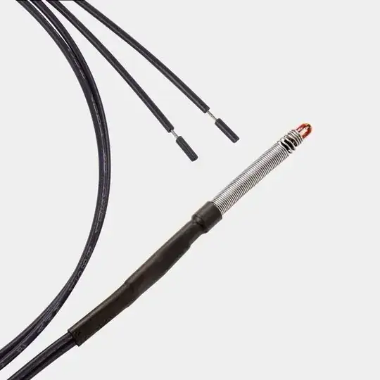

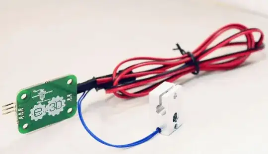

My thermistors came with a small spring surrounding them, which seems to work pretty well for this (see also E3D Thermistor Alternative). It's pretty close to the size of the spring in an ordinary pen, so you could just try one of those, or you could wind one from copper wire. I always use thermal grease as well, just like you'd use for heat sinks.

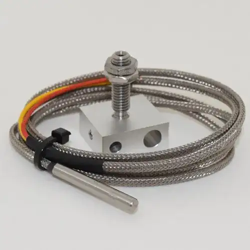

The main problem here is that the hot block has to match the temp sensor. There are a couple available commercial options for hotblocks with cartridge-and-setscrew temp sensors, but they're not thermistors:
Other popular options for thermocouples include a brass thermowell crimped onto the tip of the TC (Makerbot and FlashForge) or an eyelet lug crimped onto the tip of the TC (Wanhao).
The best off-the-shelf solution for most printers is probably to use an E3Dv6 hot block, which uses a screw and washer to clamp the thermistor leads so the glass bead tip can't pull free of its pocket.
