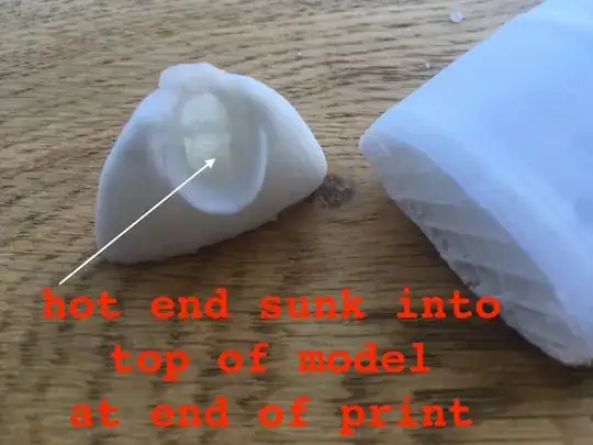

I am using cura with M3D entry level printer.
When I print things more than 6-7cm/2.5-3inches, at the end of the print, the hot end sink back into the print then gets stuck as it tries to return to idle position.
Please see the attached photo. Has anyone had this problem? Thank youenter image description here

As can be seen from the G-code file, the head is instructed to travel to x=0, y=0 (G28 X0 Y0 is actually a homing instruction to home the head and label the position with zero X and zero Y). After that it powers off the motors (M84).
From your picture, it looks like the head digs in the print without moving to the home position, so G28 X0 Y0 is not working (although you mention it tries to move while digging in?!?). That is strange as there is no instruction to lower the head. Please alter G28 to G0 so that it reads:
G0 X0 Y0
(or G1 X0 Y0 which does work and will instruct the head to move).
The digging into the print could be explained by the weight of the head/carriage that cannot be held when the steppers are not powered anymore (as instructed by M84). When the nozzle is hot, the nozzle will then dig into your print.

For some reason the G28 command to home X and Y is not having an effect. I wonder if there is something 'special' in the firmware that affects how it homes.
You can try to replace the G28 with a move (and maybe a different location would be better to place the extruder in the best position for removing your print).
G1 X0 Y0 ;Move to home position
Best would be to look at one of the included 'pre sliced' models that are usually included with a printer to check the manufacturer's default end sequence.
You might also be able to configure Cura to move up at the end of the print (so long as the print is not at maximum height).

From the provided G-code:
G28 X0 Y0
The meaning of the G28 code is move printhead to home. In theory, the presence or absence of X, Y, and Z values are used to indicate which axes the printhead should move on, but as the RepRap wiki notes, some printers ignore this, typically interpreting any G28 code as "move to 0,0,0". In particular:
Because the behavior of G28 is unspecified, it is recommended not to automatically include G28 in your ending GCode. On a Cartesian this will result in damaging the printed object. If you need to move the carriage at the completion of a print, use G0 or G1.
You should probably replace the code with G1 X0 Y0 Z[value near the top of your printer]. You could simply replace G28 X0 Y0 with G1 X0 Y0, but that risks dragging the tip of the nozzle across the upper surface of the finished print.

As Oscar commented, check the tail end of your gcode files. Most slicing software includes commands to move the head to x=0,y=0 at the very least. I am a bit surprised that your files don't appear to have this, since Cura does apply said code.
Possiblly there's something lacking in your printer's firmware and it doesn't recognize some of the gcode commands.
