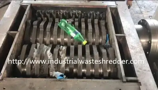

A plastic shredder machine it's better then a melting/burning solution. It is faster and it doesn't produce fumes. Imagine burning PET bottles.
For the shredder you need nothing but electricity for the motor. For plastic melting it would be much higher consumption. Additionally you could reuse shredded plastic for filament machine like Filastruder or Strooder.
There is a nice article about shredders on 3dhubs from 2015.
Then it depends on your budget. Around 400$ you can build one. A nice tutorial on preciousplastic.com. For 1000$ you can find shredder machines on Alibaba.

There are industrial shredders that will destroy just about anything. They are not cheap, at least from a hobbyist point of view. You might look into them because they might be right for the size of your company.
Otherwise, you can simply melt them in a hot oven or with a heat gun. I would be careful about getting them too hot because some filaments release toxic fumes when heated and that might pose a hazard risk with potential liability risk.
