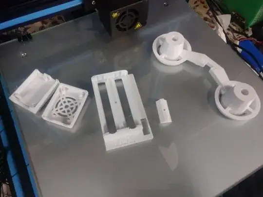

I've been printing successfully on my CR-10 for the past year now. I've had issues now and then but have been able to look around the internet and solve them. I've been using some Flashforge white PLA with great results.
Example: The whitePLA I've been using so far without much issues

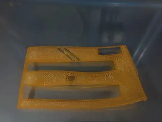

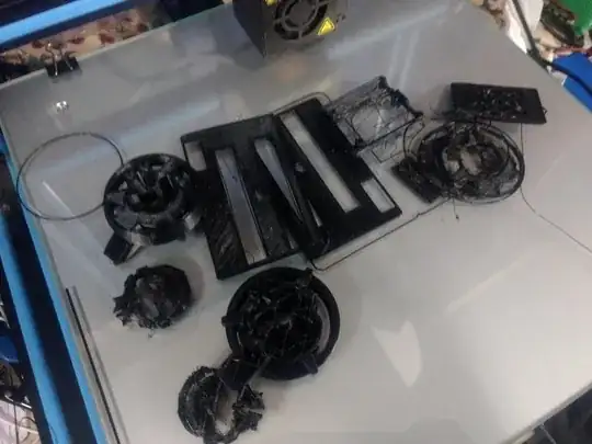

Last week I got a couple of new rolls of filament, black and orange. SinceI tried printing with them, I've got nothing but jams. The white prints fine, however.

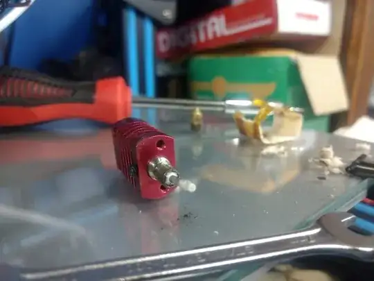

So yesterday I opened up my hotend to clean it out and got quite a bit of gunk out:
I also changed my nozzle. I printed some with the old white PLA and printed fine. The moment I switched over to the new orange filament, it jammed after a few layers.

So I made the change in my slicer but even then the first layer was visibly underextruding and it jammed soon after. I took apart the hotend and cleaned it out. Now, I put the white one back and its back printing fine.

  • that black stuff looks to be printed too hot, colors can affect temp... – dandavis Aug 17 '18 at 20:41

From attached pictures I can see that some of the printouts are not sticking enough to the bed (that can be a non-leveled bed).
As you are printing directly on the glass ensure that the area is clean (no fat or other organic substances - clean with alcohol or another grease remover) or use a PVA glue to get better adhesion.
If the Z height is to low it can clog the nozzle, if to high then print will not stick.
