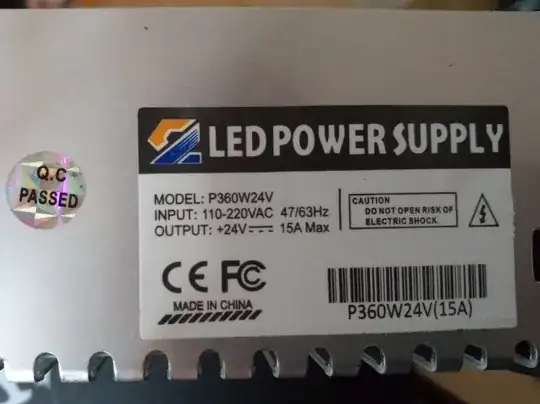

I own the Ender 3, and it runs on 24V, as this photo of the power supply shows: Ender3 Power supply

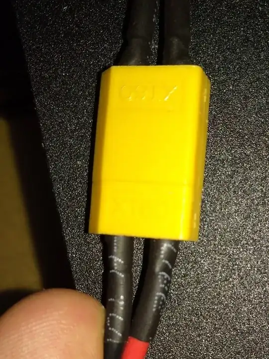

From power supply to the board, it uses a 2-wire line connected with a XT60 plug/jack that is common on RC cars: XT60 connector on Ender3

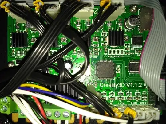

The board itself is a proprietary design and labeled as "V1.1.2". The Voltage in is the lowest input on the left: Creality3D V1.1.2
The Cooling fan (blue-yellow wire), the hotend cooling fan, heater cartridge (white shielded), bed heater (left black-red), board cooling fan (middle red-black) run (in this setup) on 24V. The Logic connectors (black-black & White-white) run 5V logic. I could not figure out the voltage of the stepper motors (upper row).
I have not figured out how the power management circut works, but it achieves this:
  • Supply voltage $ U_S = 12\ \text V \lor 24\ \text V $
  • Logic Voltage $ U_L = 5\ \text V $
  • Sensor Voltage $ U_{sens} = U_L$
  • Hotend Cooling Fan $ U_{cool} = U_S$
  • Hotend Heating Cartridge $ U_{hot} = U_S $
  • Heatbed $ U_{bed} = U_S $
The chip's caption can't be read on the photo, but it is labeled as "Δ ATMEL // ATMEGA1284P // AU 1726"
For the pinout, a german maker did determine, that it the configuration of a Sanguino equipped with an Atmega1284P 16Bit works for compiling firmware and flashing via a bootloader.

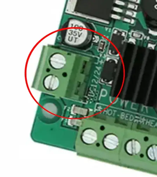

This answer addresses the input voltage. If you look up the official replacement board at the official Creality store the board features a single pair of connectors next to it says: 12 V / 24 V. So you can either use 12 V, or 24 V, not both. An internal regulator will most probably reduce the voltage anyways.
Detail of the replacement board, single 12/24 V power connector is encircled
Please note that (kindly reminded by user profesor79 through the comments) that the microprocessor on these boards only use 5 V. So any voltage you supply (12 or 24 V), the voltage regulator will always make sure the microprocessor does not get more than 5 V. However, that does not necessarily apply to all peripherals connected to the board! This should be verified if for the peripherals also a voltage regulator is used. One of my own boards, the RUMBA board can be fed by any voltage ranging from 12 V - 35 V, but this also applies to the peripherals like the heater cartridge and the fans! I use the RUMBA with a 24 V power supply, so I need to use 24 V fans heater elements and heat bed.
