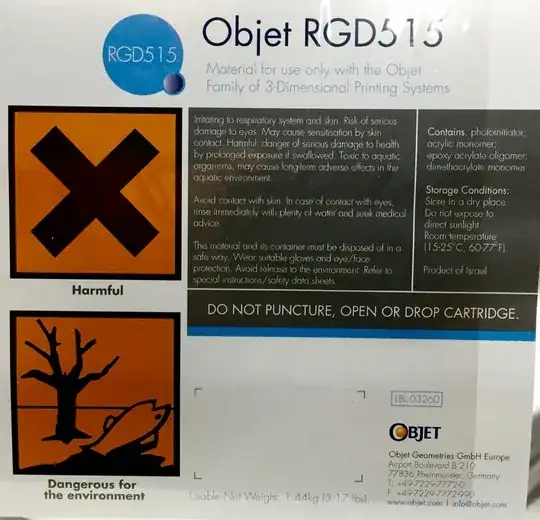

While you probably cannot find an MSDS on the resin for your printer (yet), they are out there for other resin based printers. Here's a generic MSDS on one for Objet RGD515:
It's not a pretty thing.
To back this up, Fabbaloo has two articles out which talk about the toxicity of liquid resin which is light cured. I'm not entirely positive your resin falls into this arena, but would assume since they state in the handling instructions it's toxic, it's probably right along the same lines as the other toxic resins. Please note, in the article it states there are resins out which aren't toxic. They suggest one should handle all resins of this type as though they are toxic unless you have specific documentation which states otherwise.
