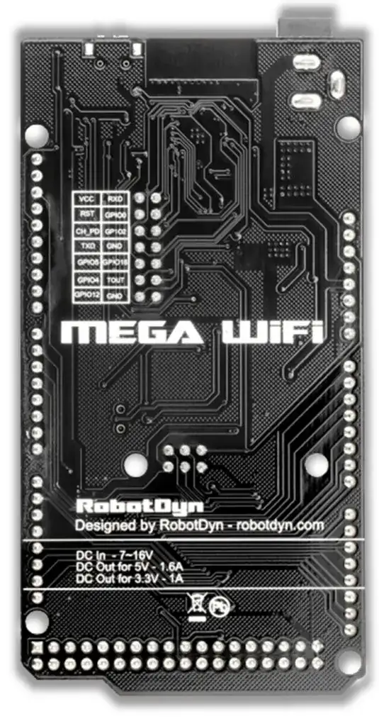

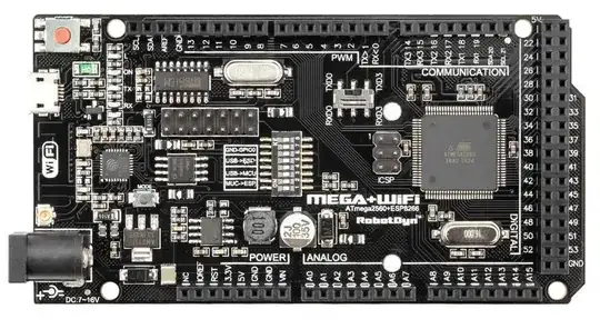

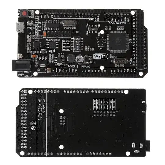

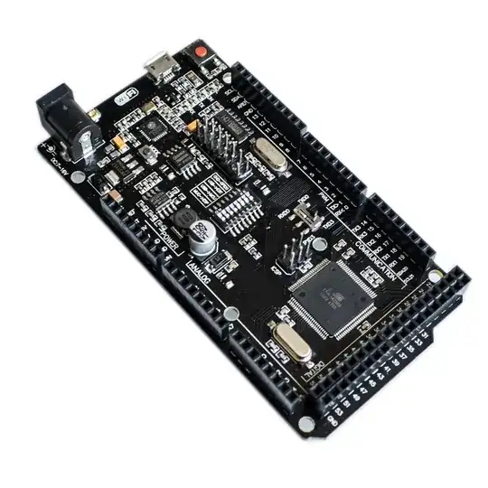

There appear to be two varieties of this board, as I have seen photos with either RobotDyn:
RobotDyn board
rear (from Instructables)
RobotDyn board (rear)

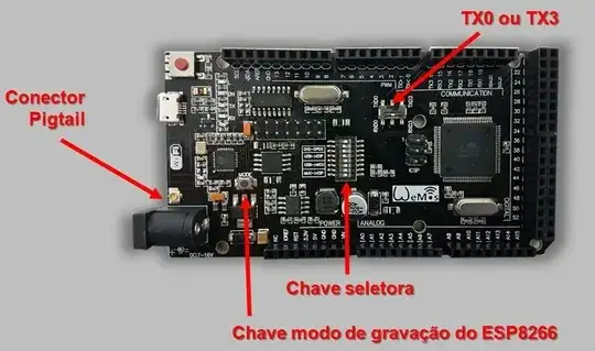

or WeMos logos on them.
WeMos board
They may, or may not, be the same. There is also this one, with just a generic "WiFi" logo (from the eBay page below):
Generic board

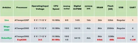

Well, looking at this RobotDyn memory table (taken from the Instructables page):

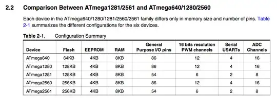

The 4 MB of the ESP appears to have been immediately contradicted and upgraded to 8 MB! The ATmega2560 somehow has 32 Mb (which seems a bit of a lie - as there isn't an ATmega2560 known to man that has that much memory2), and is confused further by the corresponding text:
As we see in the table above, the ATmega has 32MB of memory, not counting the ESP memory. This is wonderful, since the traditional Mega Arduino has only 256kb of memory.

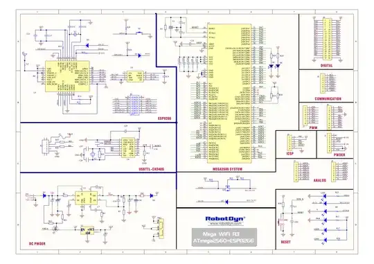

So MB or Mb? Is there an additional flash IC external to the ATmega2560? Looking at the schematic, taken from the Russian RobotDyn page, there doesn't appear to be:
RobotDyn schematic
So this could be nonsense. Logic would dictate that the ATmega has 256 kB and the ESP has 4 MB... But I could be wrong..?

2 From the Atmel ATmega640/V-1280/V -1281/V-2560/V-2561/V datasheet
ATmega256 memory
