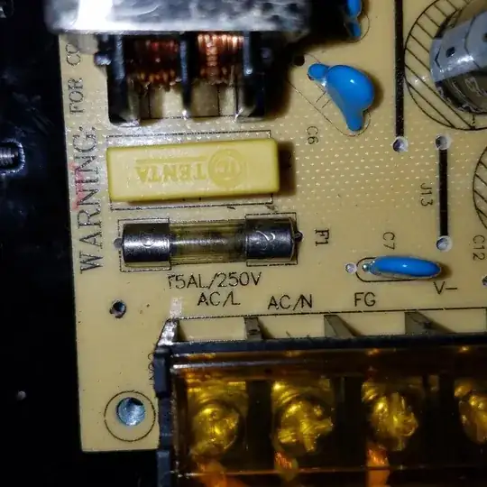

A little backstory to help you understand the situation. I put the 3D printer together and turned it on and everything seemed fine until I started printing. It didn't even get the first layer down when the screen reset and so did the print. I didn't think anything of it, I just went back and tried again, but this time right when I pressed start, the fuse blew.

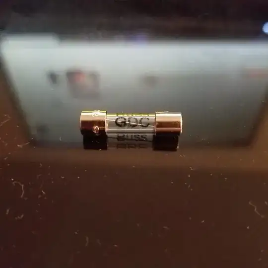

I have done some research on the issue and haven't had any luck besides recommendations for putting in a secondary fuse before the power supply (which I will be doing in the near future). As for now though, my plan is to just replace the power supply fuse if possible. I went to the hardware store and picked up a Bussmann T5AL/250V fuse (photo attached below) and before I put it in, I just want to make sure this is the correct fuse and I'm not going to kill the entire printer this time.
Picture showing the internals of the power supply unit:
PSU, cover removed showing fuse
Picture of the fuse I bought:

The fuse rating is same as described on the board - so that shall be no issue with it.
My main concern is why the fuse is down?
Was there a short-circuit? As this is mains fuse - that suggest a big-bang, so, please check carefully hot-end and bed heater connections before restarting the device, to avoid replacing another fuse.

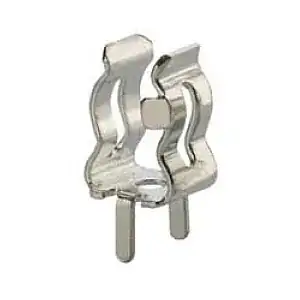

To add to the answer of @profesor79 (which you absolutely need to address first (find the cause why it blew); else the fuse might blow again), you might be interested in installing fuse clamps. As @fred_dot_u mentions:
use caution when soldering leads to the fuse that you do not de-solder the internal fuse from the caps
is that if you incorrectly solder the fuse, you might de-solder the caps, soldering the clamps is easier.
Example of fuse clamp:
5 mm fuse clamp
