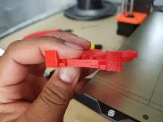

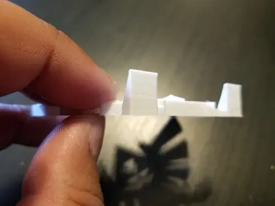

Once the nozzle and ethyl acetate came in I pulled off the old nozzle, dropped it into the ethyl acetate to soak, put the new nozzle on (per the instructions from prusa's website), and reaccelerated the printer just to be safe. I tried printing a test block and it seemed better, so I then tried a larger print and while the printed model seemed better, it was still obviously having extrusion issues and crumpled in my hand.

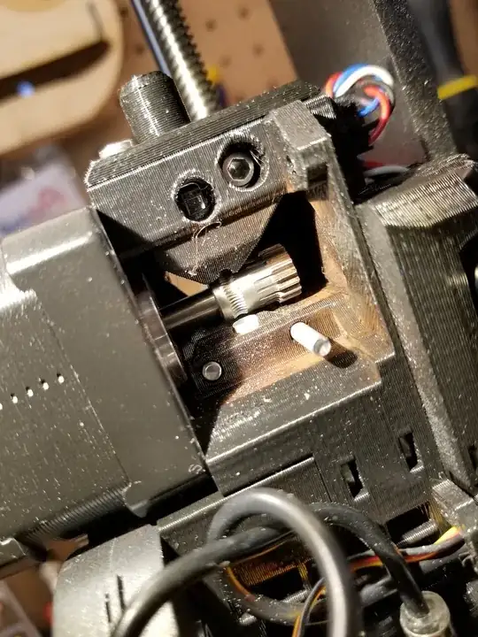

With the nozzle ruled out, I started looking elsewhere on the printer. After watching a video from the 3D Printing Nerd on extrusion issues he was having on his MK3 I decided to check the extruder pulleys. When I tried to open my extruder idler pulley door I noticed I couldn't actually get it open; it seemed to be stuck on the bottom. I tried to free the bottom of the door, but couldn't without forcing it past my comfort level. Instead, I unscrewed the top of the pulley door to remove it.
From here I noticed two things, I didn't get the pulley teeth as clean as I though I had before and the idler pulley's mounting rod was extended just a bit (which is what was causing it to stick at the bottom). I adjusted the rod and put the door back on. It was printing better but still had extrusion issues.
I then watched the pulley during the filament loading and notices that while the extruder stepper motor was turning smooth, the idler pulley was stuttering a bit while turning. I imagine those little stops and starts were what was causing the extrusion issue.
I opened the idler door back up and worked the idler pulley a bit with my finger. It started to spin free (maybe there was gunk in it? maybe it was rubbing a bit against the mount? ¯\_(ツ)_/¯), so I closed the door and screwed it back in tight.
Ran a test print -> perfect.
I've run several prints increasing in complexity and it seems like I'm back to printing well.
