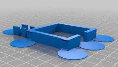

Another approach is to put mouse ears on all the corner parts, that you clip off the print afterward.
"Mouse ears" are circular shapes or discs added to the model, for more information read this post.
Example of mouse ears on a print object:
