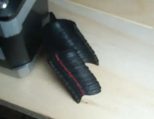

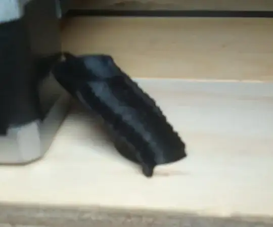

This piece is supposed to be straight up & down. Wild.
The moves that cause the shift are on this red line.

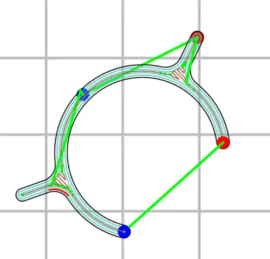

The issue seems to only occur on curved moves with a radius of approximately 2-3 mm that point their convex side towards the y-negative direction. Larger or smaller radius moves don't cause the problem. In fact sharp turns don't cause the problem either. Only 2-3 mm radius moves with their convex side towards y-negative produce the issue. No other kind of move causes the problem.
I think the offending move is highlighted here in red, but it might be one of the two moves either side of it. I haven't been able to narrow it down.
Cross-section of print

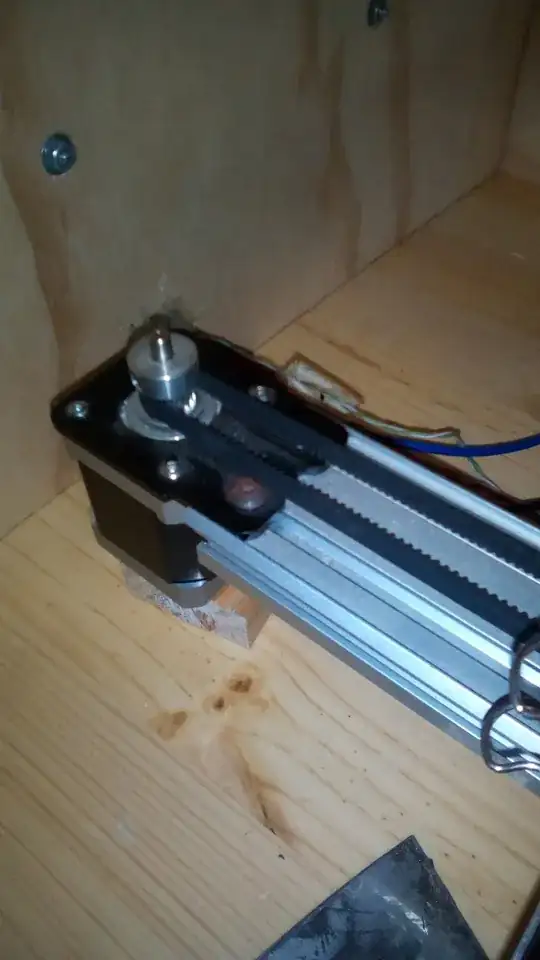

Here are some photos of the y-axis belt as requested:
Motor: Motor
Idler: Idler

A last option is your system has too much friction as Ultimaker points out in their trouble shooting guide. You said your belts are very tight. I wonder if you have them So tight you are actually creating binding. Check to make sure the belts are not rubbing in any way.
Leaning: A leaning print is usually caused by friction causing the print head to move a shorter distance than expected. Make sure that the short belts that connect the stepper motors to the axes do not rub up against the main body of the printer. Similarly make sure that the pulleys on the stepper motors that the belts ride over are not touching the side of the printer. If they are you must move the pulley closer to the stepper motor.
