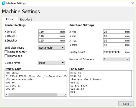

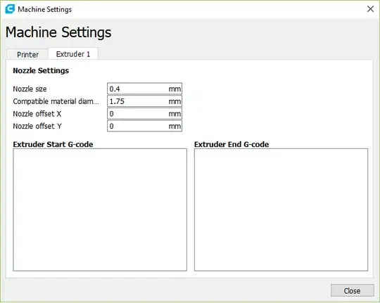

I've just purchased an Alladinbox SkyCube 3D that I want to use to print board game miniatures and other fun stuff.
However, the instructions do not give the settings I need to put into software like Ultimaker Cura, and this is where I need some help so that I can generate the G-code files from models I download from MyMiniFactory.
I know it uses PLA and the extrusion temperature should be 210°C. However, I need help with the other settings.
Can someone please point me in the right direction? Is there a better software I could be using? Where can I find settings?
Thanks.
UPDATE: For those wondering "what" settings, I would probably start with the printer and extruder specifications. The following is my best guess.
Machine settings - Printer
and
Machine settings - Extruder1
I'm basing these settings on the device specs on this page: Link to Alladinbox specs

Okay, after some research and experimentation, I've come up with some settings that seem to work.
Firstly, some specs about the Alladinbox SkyCube 3D:
  • Firmware: Marlin
  • Nozzle diameter: 0.4 mm
  • Nozzle speed: 20 to 70 mm/s
  • Layer thickness: 0.1 to 0.4 mm
  • Printing area: 110 x 110 x 125 mm (WLH)
Note: There is NO cooling fan present and the base is NOT heated.
Now for the actual printing settings...
I'm using the PLA supplied with the printer so far, and it works well at a nozzle temperature of 210C.
I'm printing at 0.2 mm per layer, which seems to afford to a good level of detail. I've printed a scanned Greco-Roman basin, and the details are very nice indeed.
So far I'm using a 20% line filling, and this seems to give the structure a good solidity and strength. I'm also operating the nozzle at its maximum speed of 70 mm/s and it seems to work just fine.
Obviously, I'm still experiments, and different materials may require different settings, but overall I'm very happy. I hope this post helps someone.

To start printing with Cura, you can select standard printer (aka Prusa i3) and set the x,y,z dimensions in the machine properties window - it is a safe point to start. Then you could print a test cube and try to dial in with speed/temperature setting to get the best quality.
