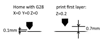

Here is is the part my Question starts: I noticed that the first layer is actually not at the same Z=0 if i use G28 to home and the Z0 it shows when i print a part. For example: Set G28 Level bed with 0.1mm thickness gauge. Then start printing with layer height 0.1mm and initial layer height setting 0.2mm
The result should be 0.1+0.1+0.2 =0.4 real layer height (if i also count the 0.1 layer heigth(not sure if this is correct)) the printer shows here a Z of 0.2 But if i meassure it, it is around 0.7mm thats way to much.

I am confused why this is the case after i changed the nozzle. Considering i leveled the bed the exact same way i did before and used the same slicer. The new nozzle is a little bit shorter but i made sure both nozzle of the dual extruder have the same height. I do not understand why this happens. Is there a way to reset the Z? I tried the M851 code but as far as i understand it, it i used for Auto-Bed leveling. It didn't work anyway, says unknown command.
I could work around the problem by adjust the endstop until it somehow works, but then if i want to level the bed and use the G28 code the nozzle would crash into the bed and that is not a satisfactory solution. Would it suffice to set a z-offset in the firmware? I don't have much experience on that area.
