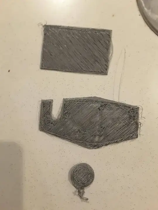

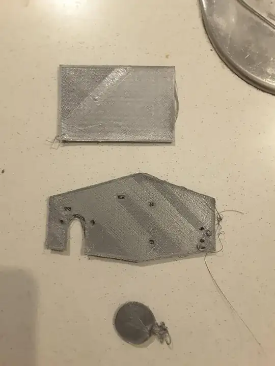

To give you an example of how the prints come out, i have attached two images (front and back) of a set of prints. I stopped these printing as they lost grip on the bed.
Bottom Layer (on the bed) Bottom Layer (contacting bed)
Top Layer Top Layer
Thanks heaps for helping a newbie out. I had tried changing speeds (faster and slower), changing temperatures and so on but i have no real idea what i am doing and was hoping someone far more knowledgable than me could give me some idea on where i may be going wrong and how to fix the issue.

Your nozzle is way too far from the bed for the first layer. You should adjust the bed leveling screws to bring the nozzle closer to the bed, to the point where a piece of paper just barely fits between the nozzle and the bed. You should closely watch the first layer as it is being put down, the plastic should get squished slightly and there should be no gaps between adjacent lines.
