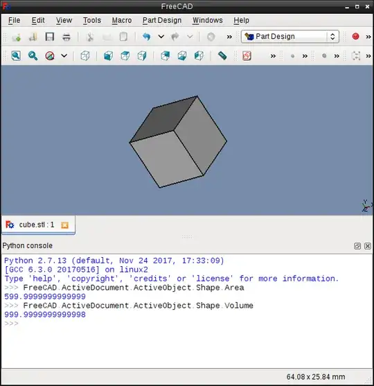

You could use the Python console of FreeCAD. Issuing the following commands
FreeCAD.ActiveDocument.ActiveObject.Shape.Area
FreeCAD.ActiveDocument.ActiveObject.Shape.Volume
will output the area and the volume of the object, respectively.
I don't know how to access the console output from outside FreeCAD, but there is an option in FreeCAD called Redirect internal Python output to report view which I think is what you are looking for.
You might want to look into the Scripting documentation of FreeCAD for further instructions.
Using the Python console of FreeCAD to calcaulate area and volume of an object
