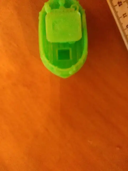

I printed this boat model https://www.thingiverse.com/thing:2763854 (with a scaling of 0.6):The quality of the print looks nice but at the last roof the entire print slipped away. (e.g. no adhesion between bed and print)

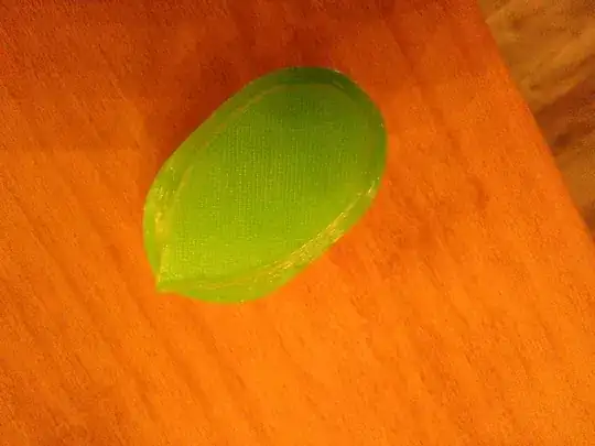

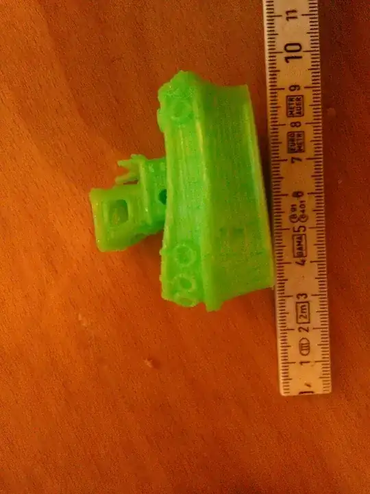

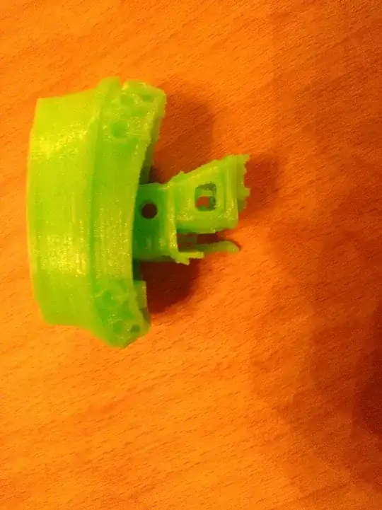

enter image description here enter image description here enter image description here
Is this common that the print can slip away? Is e.g. the raft bed adhesion a better option? I have read that glue could prevent the print to slip away. What kind of glue I should use? Could a hotter/colder heating bed prevent the print to slip away?
Thanks in advance

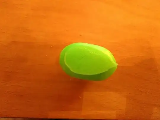

Edit: Added Pictures after extruder calibration (https://www.youtube.com/watch?v=fb7lit5ZRq4): enter image description here enter image description here

Post-photo edit: I can see in the image provided that the first layer has large air gaps. This is directly related to either the extrusion factor or the z-height. The remainder of the model looks too good to be extrusion factor, returning my first assessment of z-height problems as more likely.

As best as I can determine from your printer name, you do not have a genuine Prusa i3, but rather a Geeetech prusa clone i3. As such, many things are different. My suggestion about z-height is no longer valid, as the firmware is likely to be different for your printer.
I'm not a cura user, but my quick research shows that it's probably called flow percentage. Other posts on the 'net suggest that below 100% would be underextrusion. I've found a video that shows how to make your extruder match the 100% flow setting in the software. It's smarter to have the firmware represent accurate figures and the video will allow you to perform this calibration.
The z-height for your printer is related to print bed calibration. I was unable to locate anything useful to me with respect to that aspect of your printer. It appears that the bed has four leveling screws, although I'm not certain of that. If your bed leveling involves adjusting those screws, it is possible that all four (or three?) of them are too tight and have to be released a bit.
If you have bed calibration instructions, consider to perform them again, especially if you are going to adjust the extruder settings as per the previous video.
