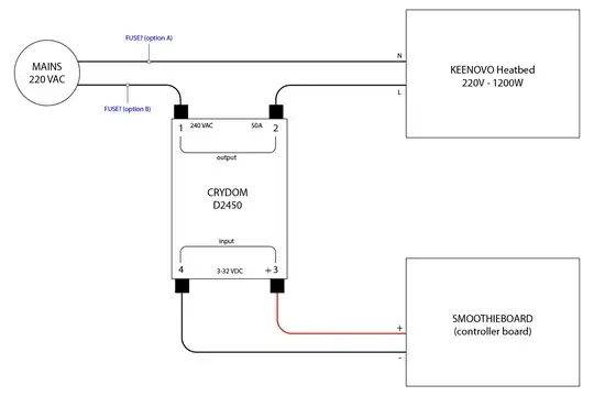

I'm building a 40x40x40cm corexy and I am quite impatient so I want the heated to reach the target temperature as fast as possible, so I ordered a Keenovo silicone heater It is a 220VAC 1200Watt bed, so I really want to make sure that it is safe to use. I also bought a Crydom D2450 SSR.
Could someone tell me if the wiring in the diagram I made below is safe?
Do I need to put a fuse or some other kind of safety?

The most important thing is the following: make sure that any exposed metal surfaces of your printer are properly grounded. This includes the frame if it is made of metal, or the aluminium plate you might use as your heated bed. In the event of a fault, having the metal surfaces grounded protects you from getting shocked when you touch the printer. If any surfaces are aluminium, be aware that the oxide layer that forms on aluminium does not conduct very well, so make sure that you get a good connection.
You should consider adding a thermal fuse or bimetallic switch to the heated bed so power gets cut in case the bed overheats (to protect against the relay failing closed or firmware errors).
In principle, if the wires used are thick enough (capable of carrying at least 16A), then there is no need for a fuse. Assuming you are in a normal European household, then the mains line will already have a 16A fuse. If your printer connects to the mains using a IEC C13 connector (kettle lead, very common) then you should have a fuse rated (at most) 10A somewhere because this is the maximum rating of the connector. For a very small amount of added safety, you could use a lower-rated fuse instead (for instance 7A) but this is not required. Your heated bed can draw up to around 5A so you can't use a fuse lower than (or equal to) that. If you are indeed using an IEC socket to connect your printer to the mains, then it might have a fuse holder (or try to find a socket that does).
Your image suggests two possible fuse positions. It would be advisable to place the fuse near the live/hot connection, but as European power sockets are non-polarized, this is essentially a moot point.

The diagram you show is in compliance with the manufacturers' specifications so far as connections go. Make sure any wire you supply is rated for the voltage and current intended for use.
If there is not a safety cover (typically clear plastic) over the junctions where you'll be attaching wires, you should add a cover, or alternatively put the entire relay inside a UL-rated box with stress-release feedthrus for all the wires.
It never hurts to add a fuse or breaker in the source hot feed. I'd recommend slow-blow. NEVER fuse the return side, since a fault or blown fuse here will leave everything live and floating
That said, this is more of an electronics question than a 3D printer question, so you might want to wander over to electronics.stackexchange for information on general design safety for high-current systems like this.
