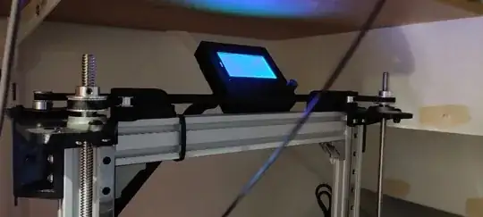

I once bought oversized screws but was a little too lazy to grind them down, so they are still sticking out, no problem.
