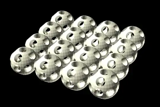

small test
For reference, the code at the bottom of this answer (which generates the image above) behaved like this:
  • With render(): 15s for the preview, 1m29s more for the proper rendering (TOTAL: 1m44s).
  • Without render(): 0s for the preview, 1m45s more for the proper rendering (TOTAL: 1m45s).
I don't know if the fact that the totals resemble each other is a coincidence peculiar to my model or a general rule of thumb (the render() function effectively creating part of the final rendering during preview), but you are free to play with the code and if you find out a pattern, please leave a comment.
In the following code, you may need to increase the grid size to 20x20 if you want to see the difference in responsiveness between vanilla code and render() function.
Also remember to close and reopen OpenSCAD between tests, in order to flush the cache.

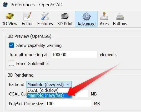

To speed up the rendering, just change the rendering option to the new Manifold: Edit > Preferences > Advanced > 3D Rendering > Backend > Manifold (new/fast). Then restart OpenScad to use the new rendering engine.
Screenshot of the OpenSCAD preferences showing the location of the option for faster 3D rendering
This option has been available since version 2024.09.28.
Rendering time before: 0:00:21.824
Rendering time after:  0:00:00.013
It's about 1678 times faster than the old one. I don't know why this is not the default option.
